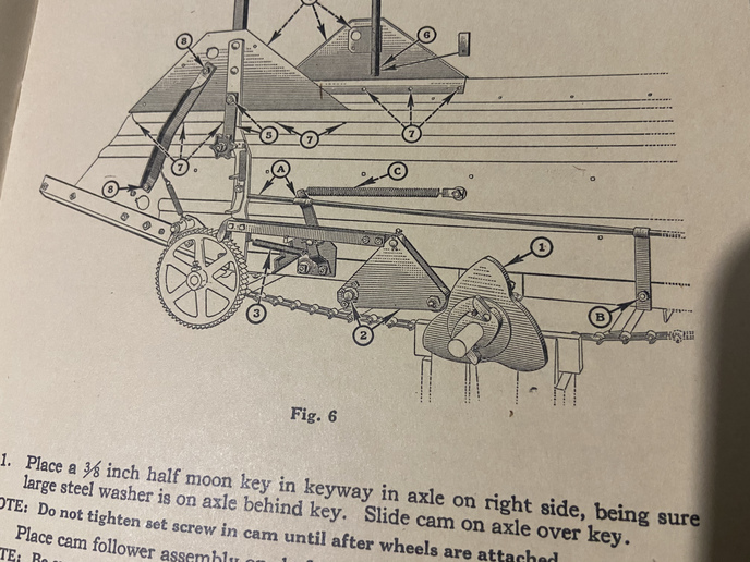

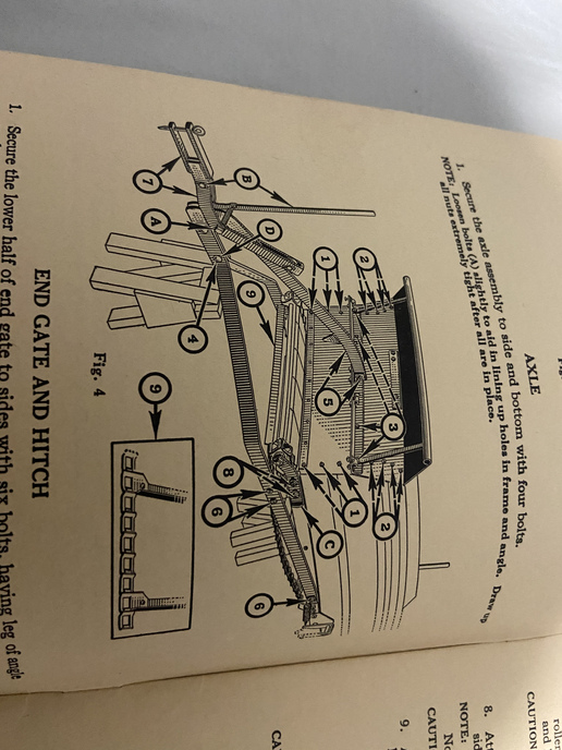

Last week I posted about my manure spreader project and someone said I had it installed backwards. I didn't think I had and I didn't remember seeing any done differently from mine, but I've been wrong before. So this weekend while I was at a local consignment auction I looked at several there and all but one was done the way I did mine. The other had the chain in the same, but the slats were in the other way. So I decided to pull out my Case manure spreader manual and see what it said. Here is what is in it.
Other pics in the book show it in the same too.
So I guess my broken apron problem is not from installing it wrong at least. That's a relief.
