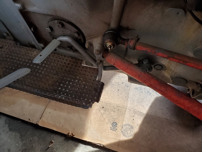

An 800 will have the left side brake pedal shaft crossing in front of the rear housing to the left side of the tractor as shown below.
An 801 will have the left side brake pedal shaft crossing under the rear housing to get to the left side of the tractor as shown below. My project 841 has the rear mounting bolt for the running board broken so it makes a good demonstrator to show the 801 left brake shaft routing.
