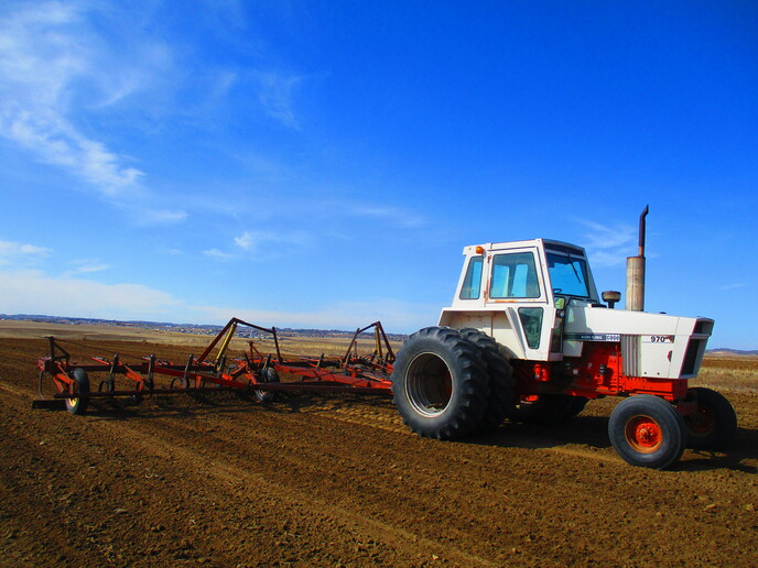

16 lbs min for your size tires, if carrying some thing really heavy up to 18 psi no more, running less is very hard on sidewalls,, especially with today's tire compounds, only thing I run 10 psi in are my outside duals 20 psi on the inside on the tractor in the pic
