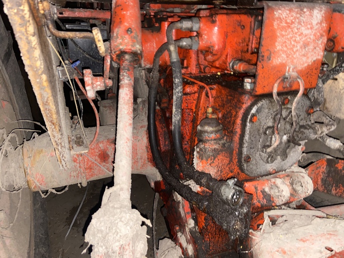

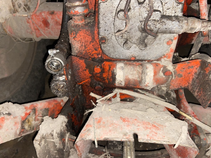

Here is a pic from my 1030. The angle brackets bolt on over the third link bracket. The coupler holders you have only fit case couplers. You can get them either at salvage yards or most places that sell hydraulic parts should have them. I change all mine to pioneer couplers to get the push/pull type that are easier to hook up.
