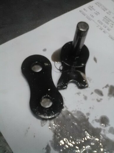

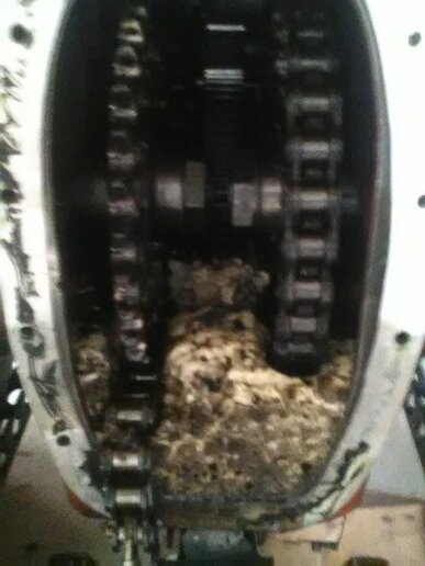

Went pulling over the weekend--did real good Fri. but broke the left drive chain in the rear of Abe on the first hook Sat. Case put 140 chain in it but we are replacing it with 140 heavy. The supply house Mc Master says it is over twice as strong as 140. I wish Case would have done that 70 years ago--they want $58 a foot and it will take 11 foot. Reminds me what the local fix-it shop in town said about a guy's Gleaner combine that spent most of the Fall in his shop--If a 1 and 1/4 in shaft would work--Gleaner would put in a 1 inch---Tee

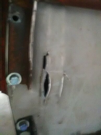

Tore a hole in the 3/16 aluminum cover on he back of Abe
Broken link we found--still fishing for the end of the link in the trans. case--about the size of a half of a silver dolar
