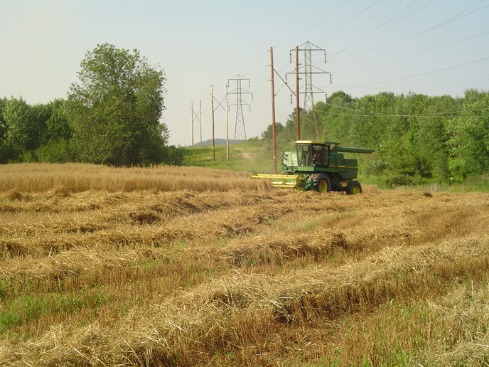

I 2nd the guard extensions, I put them on a JD 6620's 12' grain head and they worked very well. Kind of like you described, just before they are good to combine, they go down, wind, rain/storm or even the darned deer bedding down. Another consideration, is how much nitrogen is applied. Sometimes it makes them grow too tall, certainly increases the straw yield, but being so tall, they go down easily.
