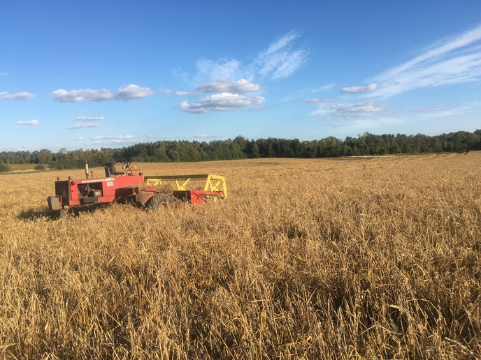

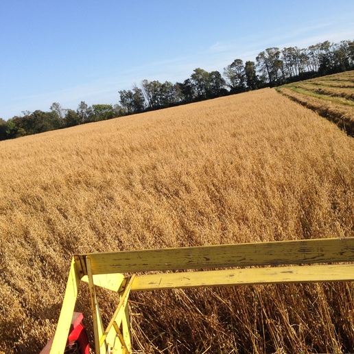

I am 50 miles north of Lake Ontario, so not really all that far north, but I have swathed oats successfully many times
Life is full of trade offs. Swath them too early and then face two weeks of rain, it can be difficult to get them dry. Swath them later nearer to dead ripe, and swathing will cause some grain to shell out. Its a gamble, I have had 30 acres lay for over a week in rains, then flipped it, and had very little loss, and good harvest.
Nice heavy windrow will turn a lot of rain, but a light crop will get beat into the stubble
