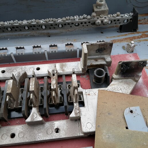

Load center has aluminum buss bars.
I think you can see the burnt places on the bus bar.
Electrician said it could have burn the place down.
I replaced it with square D, the only brand sold at the 3 supply houses in Terre Haute.
There was an old inspection tag inside meter base. The new load center was installed by a union electrician, work was permitted and passed inspection. New green tag inside meter base. Start to finish 2 hours to install.
That included time for disconnect, install inspection and power reconnect.
So John, how many other unsafe load center are out there? I think General switch is out of business.
George
