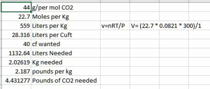

Here is what I have come up with, it looks like a 5 pound cylinder would work:
