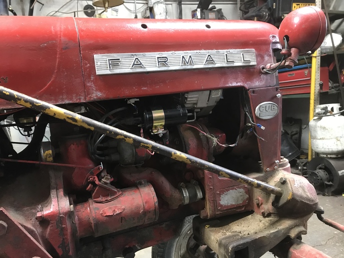

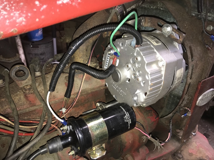

It was recommended here that Hatachi alternator 14231 was a good fit and a. 3 wire hook up. I ordered one for a Cub on line about $38.00 bucks. It would bury the amp meter at full rpms. It was charging at almost 17 volts. I called tech support and was told I needed a regulator for it to work. I gave up and installed a Delco. It is a tight fit but is under the hood. Has anyone had success with the Hatichi?
