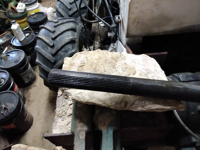

Been a few days but I got the trencher done.
Here's the new spider gears.
They did such a job packing the new axle I had to cut the foam off.
They made the axle to fit many different widths by making the spines long.
I managed to get the unit in without a case spreader. Ready for the cover!
While I had it in the shop I had to redo the ignition switch, new gauges, and new shaft seals on the injector pump. I hope that fixes the fuel in the oil problem I don't see how else it gets there. No lift pump. Could be a leaky return line under the valve cover but I ran it with the cover off. No signs of a leak
