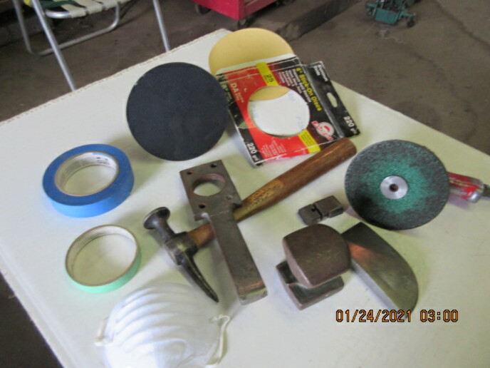

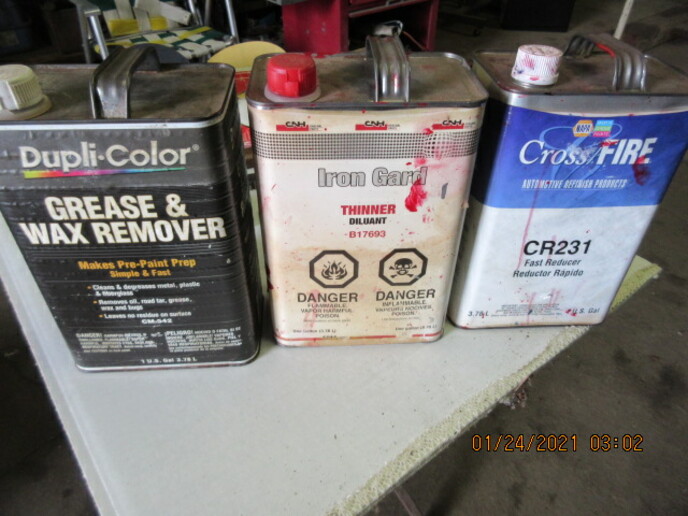

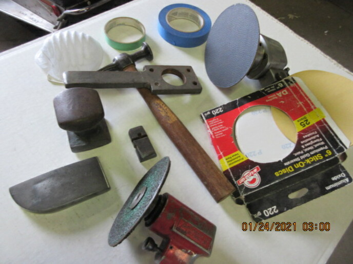

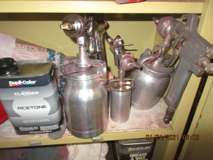

Plan on spending every free minute you got for a long time, clean, clean and clean it again. If you need some body work on the sheet metal don't be afraid to spend about thirty hours on a grille and I use the RED/Green philosophy for straightening metal, "any tool can be the right tool" whatever's in the Junk pile for a dolly.
