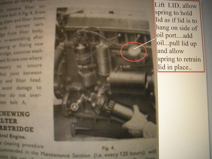

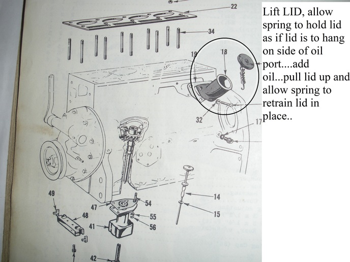

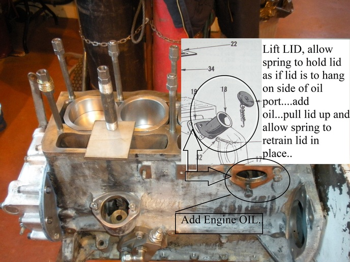

Quote:
On the ign side of the engine block there's an oil pot, has a spring loaded lid? Is that a breather or should I be filling with oil? The lid I'm unsure whether it comes off or do I just leave it?
Yes it has a SPRING retention lid..
Lift LID, allow spring to hold lid as if lid is to hang on side of oil port....add oil...pull lid up and allow spring to retrain lid in place..
