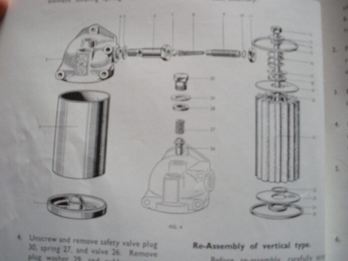

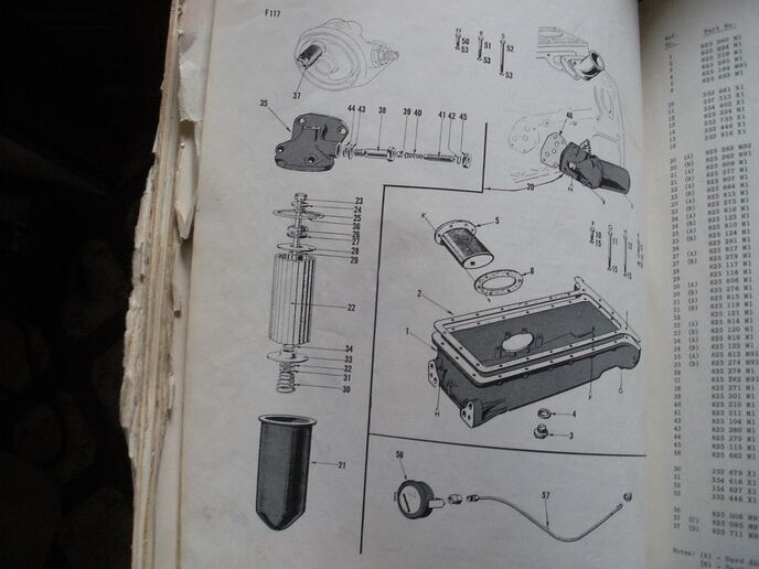

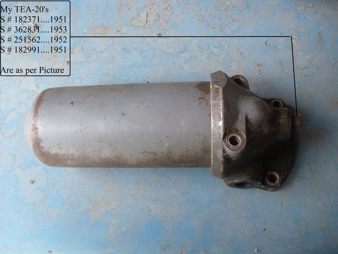

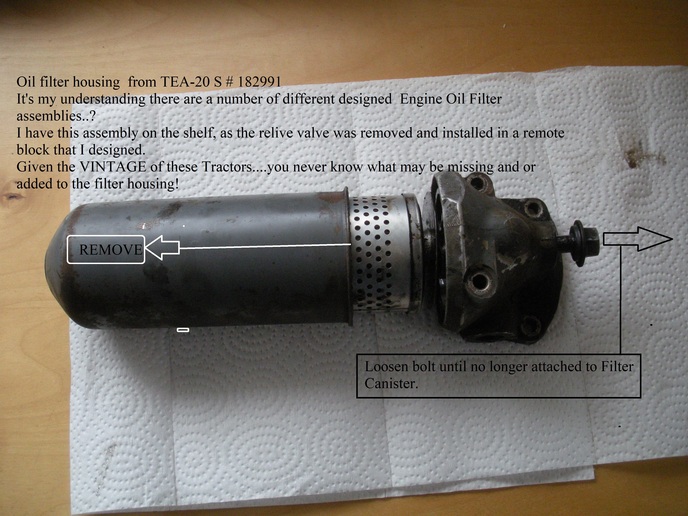

Oil filter housing from TEA-20 S # 182991

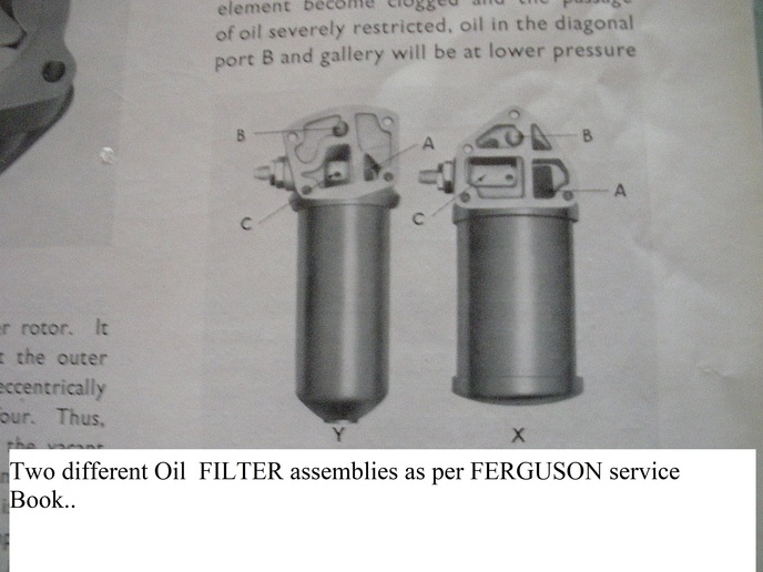

It's my understanding there are a number of different designed Engine Oil Filter assemblies..?
I have this assembly on the shelf, as the relive valve was removed and installed in a remote block that I designed.
Given the VINTAGE of these Tractors....you never know what may be missing and or added to the filter housing!

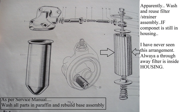

Two different Oil FILTER assemblies as per FERGUSON service Book

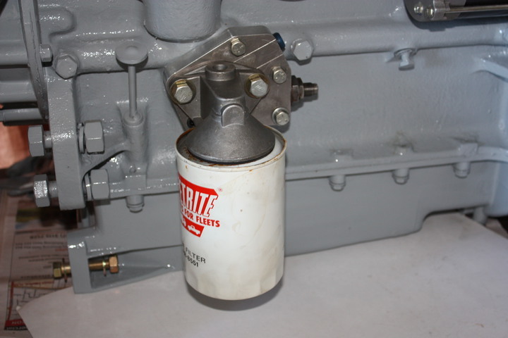

There is a company (Lowe Industries)in Australia that advertises a spin on OIL FILTR UPGRADE for the TEA-20....as well as high compression PISTONS...serpentine belt.. drives Cooling FAN as well as Alternator..
Apparently.. Wash and reuse filter /strainer assembly..
