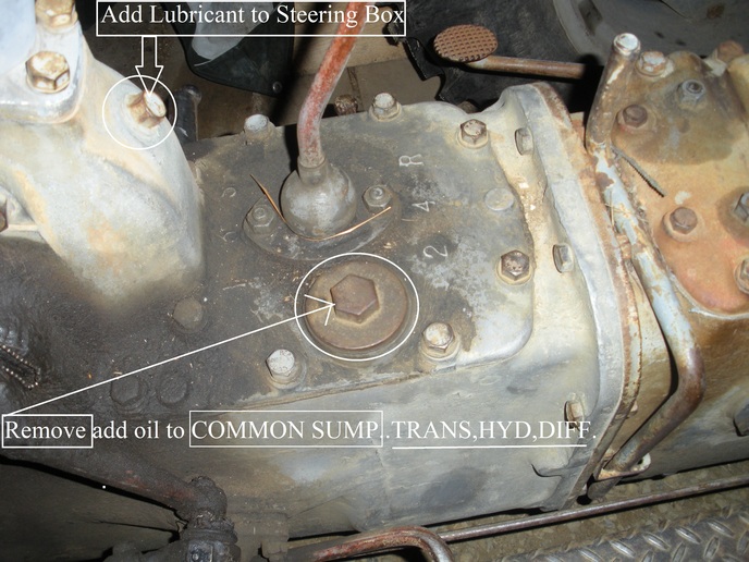

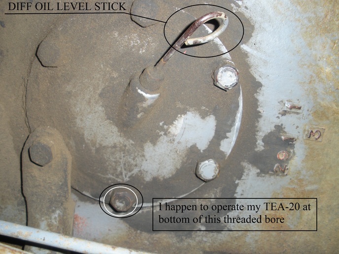

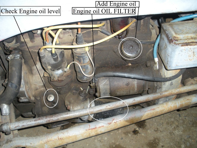

Pics to get you started Sir.

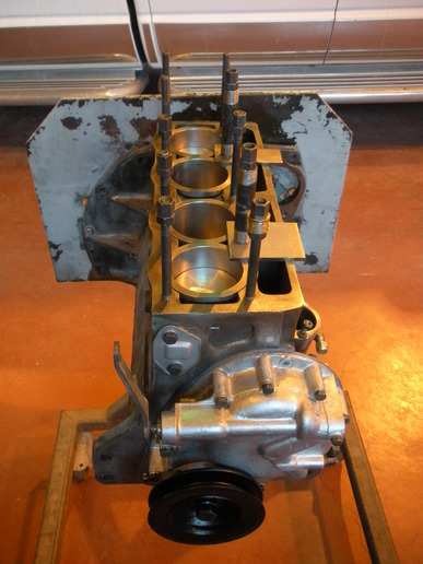

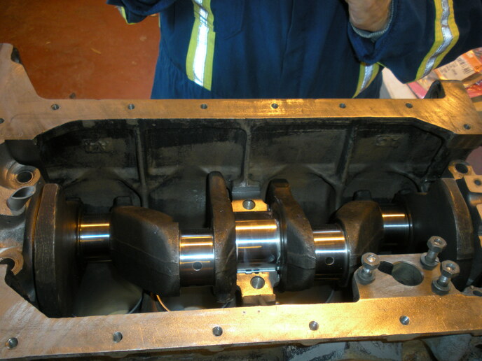

And at no cost ..a pic to wet your appetite as to the innards of this Engine.:)
