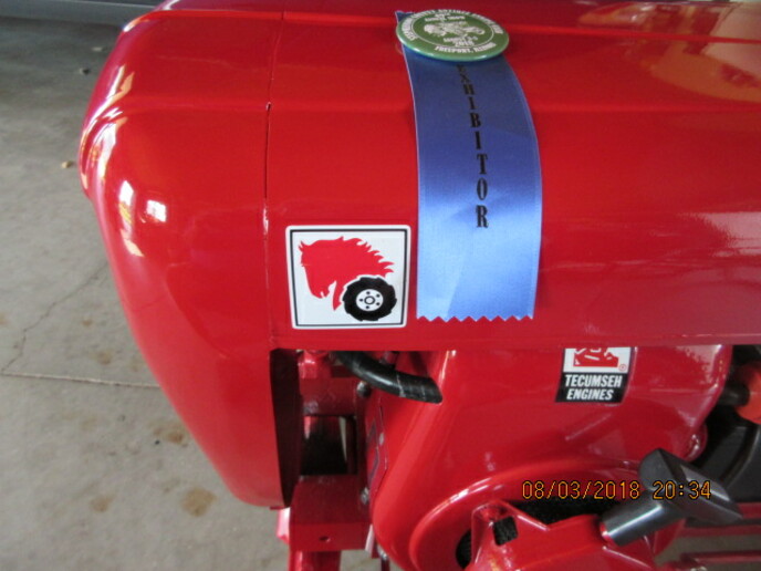

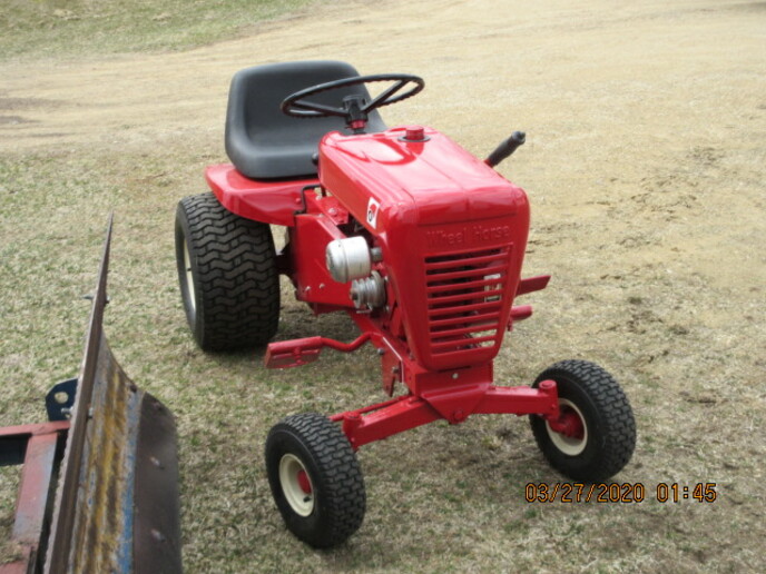

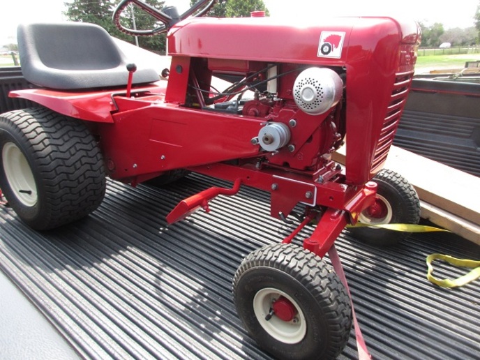

I got a free little wheel horse in about 1980. It would start but not easy and would start loosing power within about
20 minutes, I could turn out the power needle a hair and it would be normal for a few minutes and die. I tried
everything over and over and parked it in the shed for over 30 years.
Ran across another running Tecumseh 6 Horse at an auction a few years ago for 5 bucks and started swapping parts. When
I swapped the flywheel she came to life, starts instantly and runs like a new one.
After all that I rebuilt the whole thing a couple summers ago.
