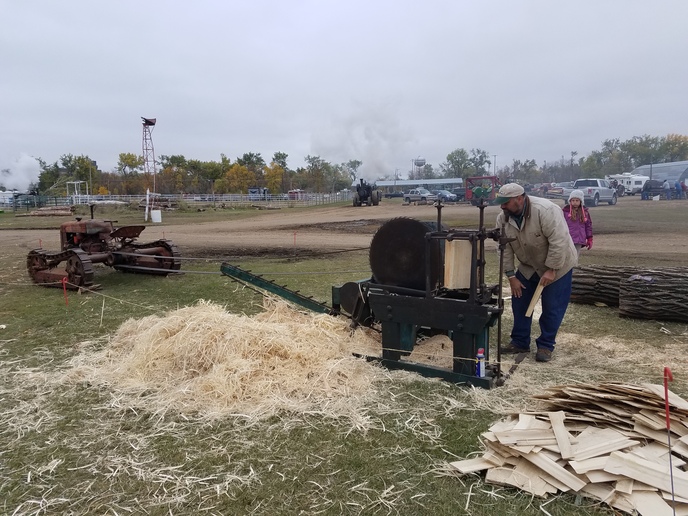

A twist top to bottom will change the direction of rotation. On some belts you can also use a twist inside to outside. It doesn�t change direction, but it will
keep the belt from flopping in the wind. (Some splices or belt material prevent this)
A long belt with no twist can get blown off the pulleys when working in windy locales.
This is a shingle saw that I have.
