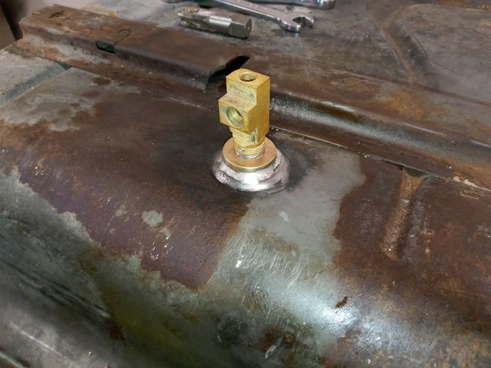

I just did that job a couple of months ago.
Friend of mine had a good used gas tank and
needed it for his 841 diesel.
I made a simple brass bushing and soldered
it on the bottom of his tank. After I
soldered it I drilled through the tank
itself. You could also just buy a brass
fitting and cut about 1/4" of it off to use
as the bushing.
It was pretty easy to do.
