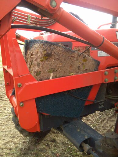

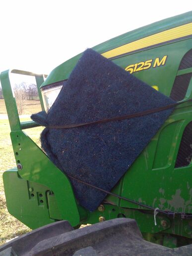

With a gas burning '49 A you'll have about 14 more HP than the early fuel oil burning A's. Should be enough HP for a two row picker with wagon assuming you have fairly level ground. Creeper gear would help but that's something you have what you have. Standard low gear is about 2 - 2.5 MPH. If you just have a few acres, then I would look at the shape of the picker you're buying more than the number of rows. Also, maybe hold your planting rate down a little. By the way, the John Deere 237 two row mounted picker was designed to be used on a John Deere A. I've attached pictures of what I use to keep dust and chaff out of the radiator fins. I've been using these for over 20 years on all my equipment including cars and trucks. They can be beaten out easily although the best way to clean them is to hang them out on the line in the rain. They're furnace filter bats.
