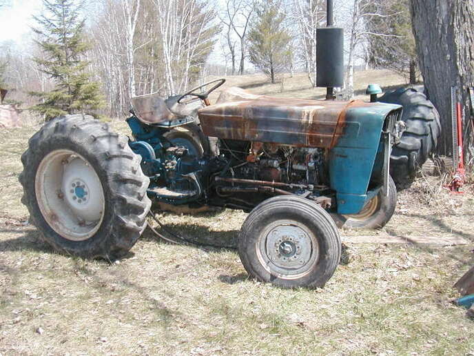

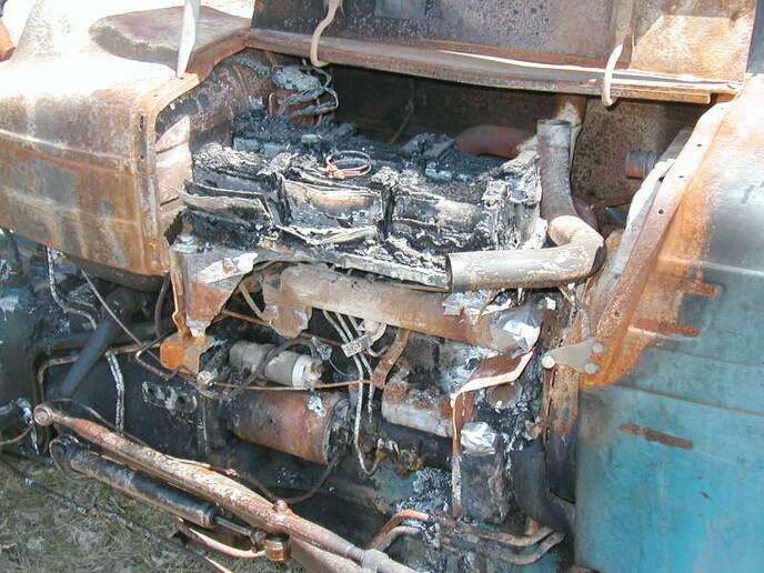

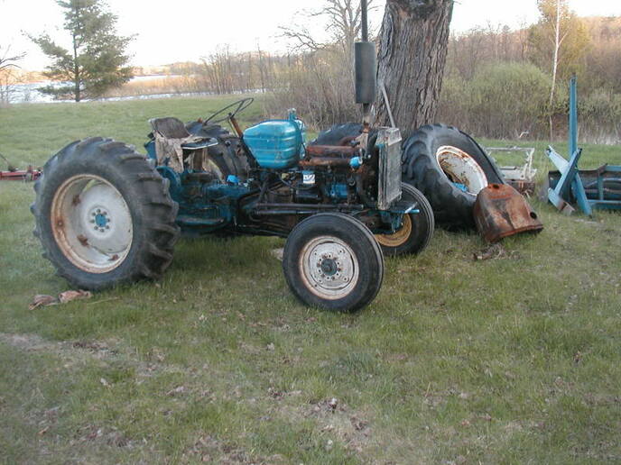

I rehabbed this one about 12 years ago.
Fire dept got there just in time.
Electrical fire on a Very greasy, oily
tractor. It burned all the peripherals off
the engine. Fuel in the tank did not burn.
I bought it because I had another one like
it with a broken crankshaft and had all the
parts needed to fix it. The deciding factor
was when I pulled the valve cover. It was
dry and brittle but not charred.

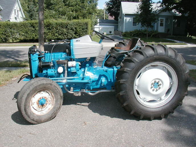

I had it running in a couple of days.
The rest of the rehab took a few months.
