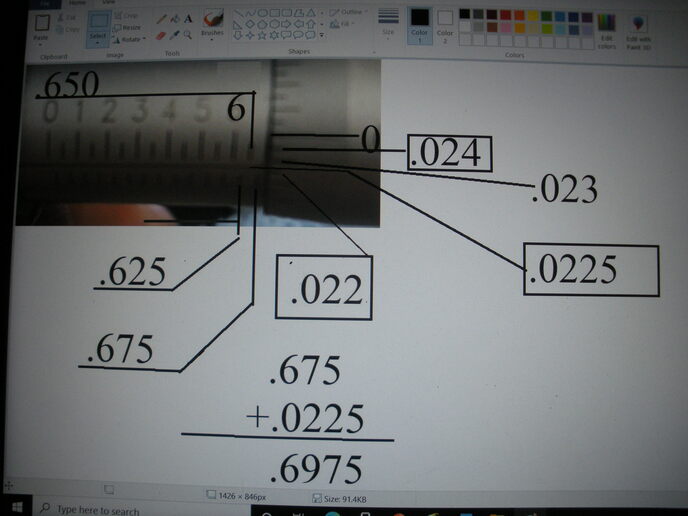

Re: Micrometer reading 101
Posted by John Deere D on December 18, 2020 at 14:16:12 from (204.244.59.67):
In Reply to: Micrometer reading 101 posted by svcummins on December 18, 2020 at 13:28:20:
Bob...
