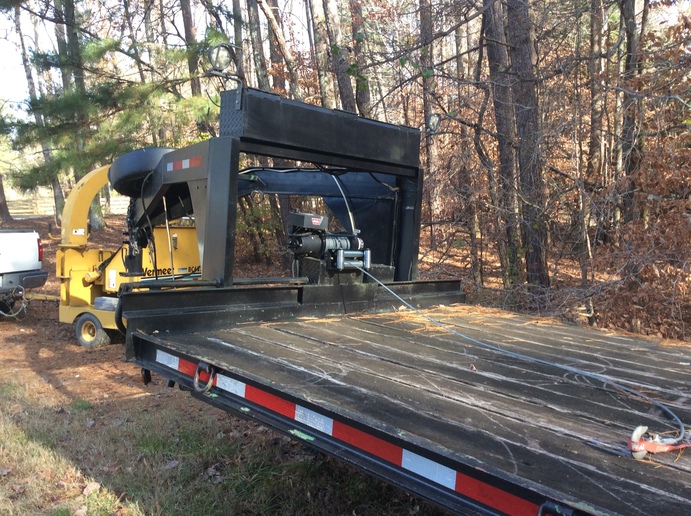

JMHO but I fear you�re mounting it too high, when you�re just getting up on the trailer, it�s going to have such an angle that you may find it trying lift whatever you�re pulling off the bed, I would at least go ahead and fabricate a pivot pulley down closer to the floor of your trailer for when you need a low pull. Mine is mounted about 16� off the floor and with my 8� ramps, I get the other extreme of the cable trying to dig in. SDE, I will be cutting a piece of pipe to follow what you have done, good idea! As for power, I have 2 group 31 batteries to power the pump for my ramps and the winch on the front, and a 4 gauge cable going up the neck to a plug in the bed to recharge them while driving.
