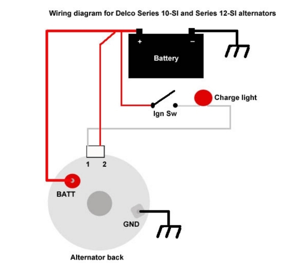

If you can wire it like this diagram you won't need to rev it to make it charge.
