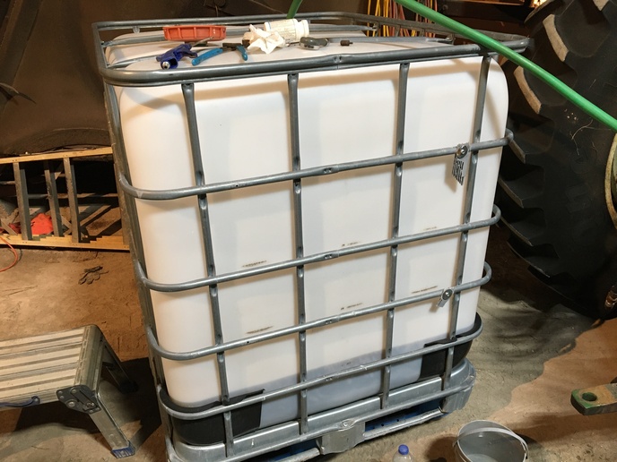

The rear tire on my 1850 is leaking fluid. I got an adapter from Napa to use to remove the fluid.
There wasn't enough room so I had to add a hose between the adapter and the valve. I hooked it up,
aired up the tire some and opened the valve and started draining it. Had to add air a couple of
times, but got fluid out to the level of the valve stem. How do you get the rest of the fluid out
or do you just have to break it down with that much left in the bottom? I released the valve on
the jack to let the tire go down flat but the jack is loose and the tire is only down a little,
not sure why it didn't go on down and get more fluid out. Any way to get a small tube thru the
valve stem to suck more out of the tire?? Chris
Fluid stopped coming out and the air came out and the tire is still standing like this. I thought
it would go all the way down. What do you use to clean up the rims? Just water or something else
to get rid of the calcium?
