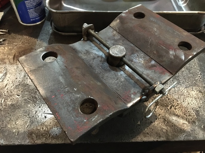

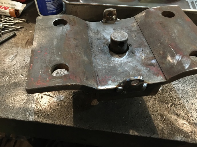

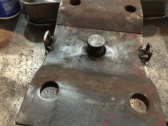

My old Oliver 550 has what looks like a drawbar attachment from a Ford made over to work on it. Where the front pin for the drawbar hooks under the tractor was a pain to get out, When I got it, there was a long rod stuck thru the pin hole and bent around until it wouldn't come out. If you wanted to remove the drawbar, you had to unbolt the mounting plate to take the pin out. I have it off for the time being and kept looking at it for a better way, Finally decided to weld two tabs on it and stick a long bolt thru it. This part bolts directly under the transmission so not a lot of room to work with it.
The pin goes in from the bottom and this is the top that fastens under the tractor. I always seem to forget a before picture. Chris
