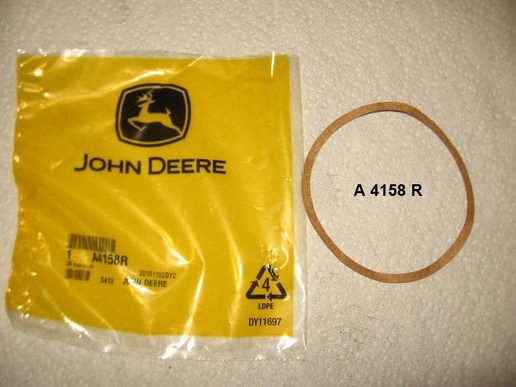

Mount distributor and gasket on governor case, making sure driving lugs engage slots on governor drive coupling.
A gasket must be used between distributor and governor case.
