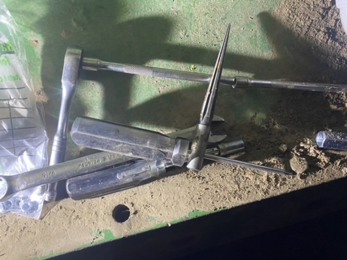

Had to put my harbor freight reamer to work reaming out the holes in the cable ends to fit over the stud on the new starter
made my life easier a long time ago and replaced the hind bolt with a stud sure makes it easier to work on
