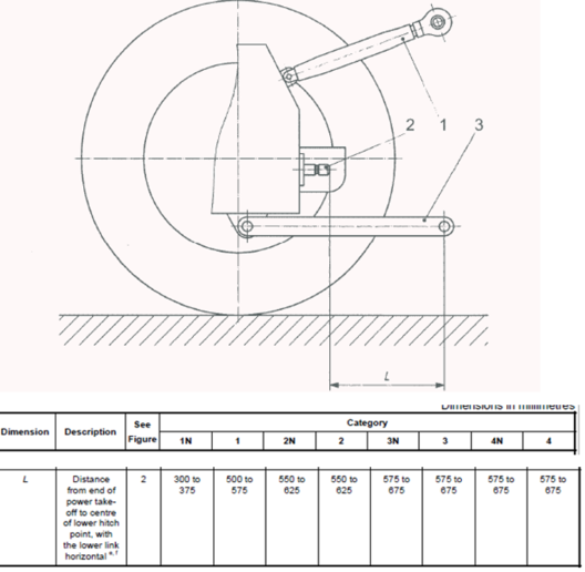

Re: 3pt measurement from pto to lower link end
Posted by ASG on October 27, 2020 at 12:04:55 from (76.77.193.148):
In Reply to: 3pt measurement from pto to lower link end posted by Shawnba67 on October 27, 2020 at 11:01:56:
See picture. Distance depends on category.
