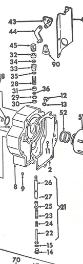

Here is diagram of PTO valve. Item #27 is the tiny pin that can break . It connects item 26 and item 25. If I need to replace the broken pin, I have used a needle roller from the cross and bearing cup of a pto U-joint as a pin. Just grind it to length as needed . Better than the $$$ Case IH will charge for one.
