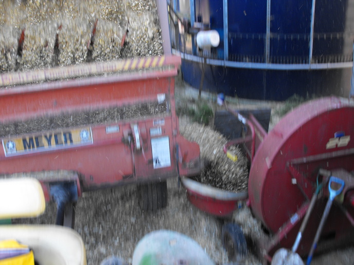

I had Badger forage wagons and I was very happy with them. I stored them inside which helps any
equipment last. You could buy a different sprocket to make them unload faster. Later I hired chopping.
They had kasten boxes. After that I hired a guy that had Meyers boxes. The last 2 had variable speeds
which I usually had wide open to unload except into a bagger. The variable speeds slipped if it was
drizzling. Corn silage I would unload in "high" or as fast as the variable speed would go so thay all
were essentially one speed boxes. In haylage I was use "low" which was too slow, but "high" was too fast
50% of the time. If looking for used I would buy Badger boxes, they were very dpendable for me.
