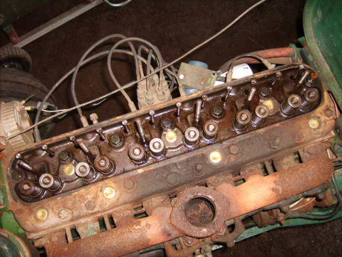

Look under the valve cover to see if there are any in the head. My Oliver had signs of water in the oil. It has seven brass welch (not freeze) plugs on the head and three are under the valve cover. The center one had a slight leak indicated by no sludge there. If you find one bad you should replace all of them.
