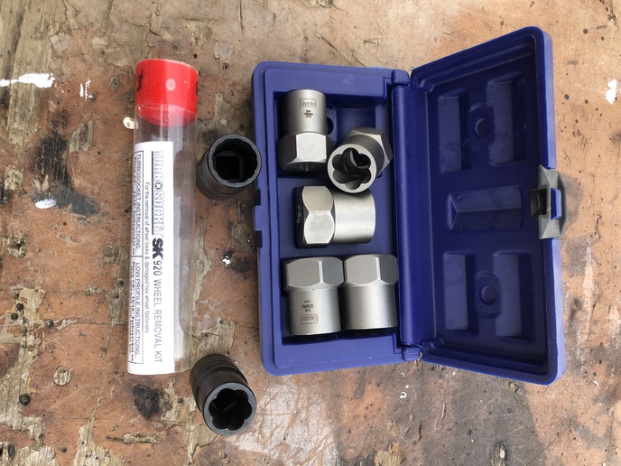

I had the exact same problem. The first set I bought from Grainger
part number 12 P185 worked great. Then I found the Irwins set part
number 54125 so I bought it to just in case I ever need it. Put the
socket on tap it a little and then twist the lug nut off socket bites as
you turn it
