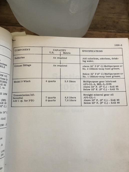

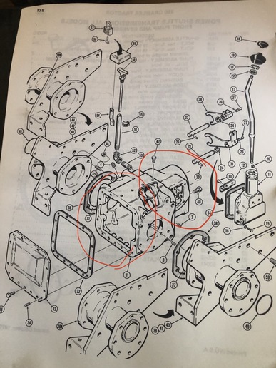

Hey guys, just servicing the old crawler. For starters, the manual Calls for gl1 mineral gear oil.... what would be an acceptable modern day substitute for this fluid? Secondly, the differential only has a plug to add fluid through, how much fluid goes in considering there is no sight glass, dipstick, or check level plug? And thirdly, as seen in picture, the �transmission�, the right hand circle, also takes gl1 straight mineral gear oil? Thanks guys!
