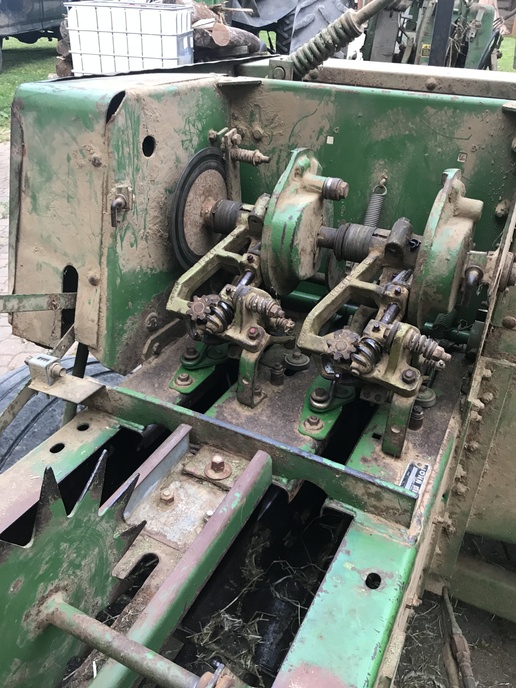

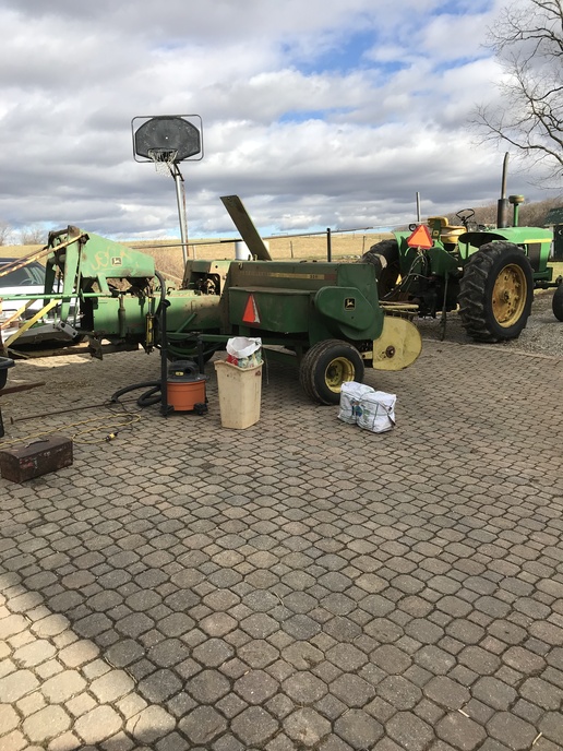

Takes about 1 hour to dig out the old bales, shop vac the crumbs, grease things and look the machine
over for winter maintenance. My balers sit outside under rubber roofing so they need to be clean. One
year I got lazy and left a bale in. It got damp, swelled up and the PTO yoke broke on the first new bale.
Never again. No reason to save time that way. On the main use baler it is rumbling so time to check the
plungerhead rollers again. That is about an hour. Need the machine empty anyway.
