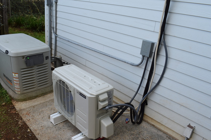

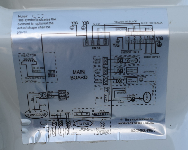

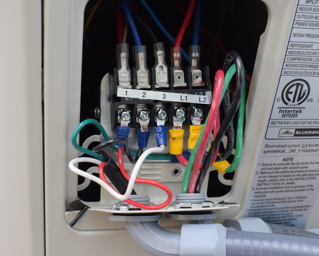

Putting in this system and can't find any real info on the wiring. The schematic shows "yellow or black" and a Brown, the install manual says follow the label. No mention of White. I think I have it right, but it is a head scratcher. Are yellow and brown European colors, there was a lot about rules of refrigerant disposal laws the pertain to the EU.
