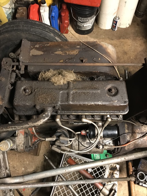

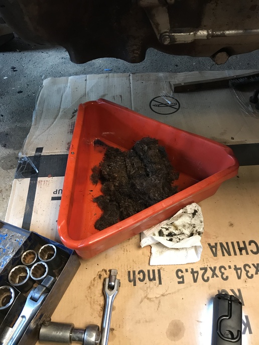

Dale, I bought a TO-35 couple of years ago. I was also thinking of driving back, about 30 miles too. But
ultimately I borrowed a trailer and hauled it. Good thing. The steering was sloppy which I knew while
looking it over, but a few other things were found when going over it
Mice had dragged nylon carpet thread into the transmission housing for a nest. It was just about ready
to get snagged by the clutch and wrap everything inside
There was a mouse nest between the exhaust manifold and the gas tank. A long drive may have set that
on fire. No putting it out before the tank went kaboom. So, I was very lucky I hauled
Pictures loaded in reverse order. Be safe
