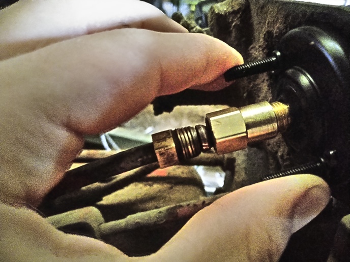

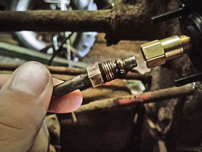

I can't get it to fit over it, it seems like both the gauge and the line are 1/8th . I know the original gauge was a female and the new one is a male. Here are some pictures. I was thinking to maybe cut the extra part of the line off with a hacksaw but I was leary of getting any metal shavings in there. The second photo I have attached is of how far I can get the fitting on.
