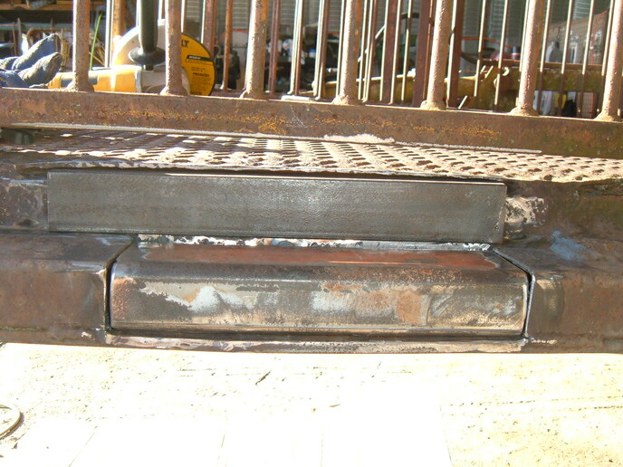

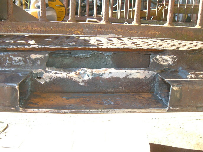

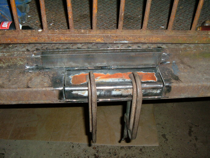

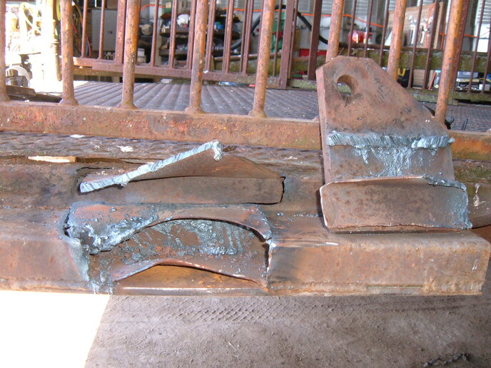

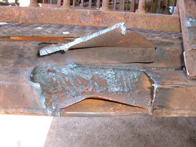

I belong to the Antique Engine and Tractor Assn in Geneseo, ILL. The club needs a handicap people mover. I have thought for a while that a hydraulic hog cart would be just he ticket, you could let it down to ground level to load and then raise it to haul them around. I was telling a neighbor about it and he said they had an old one that they didn't use anymore that needed some repair that he would donate to the club. I picked it up this am, one of the cylinder mounts was tore out and needed fixed. It was too bad to heat and bend back into shape, so I cut out the bad parts and found some scrap to make new pieces with. I got them cut and fit, ground the rust off around it and am ready to weld in the patch tomorrow and then start on the cylinder mount.
