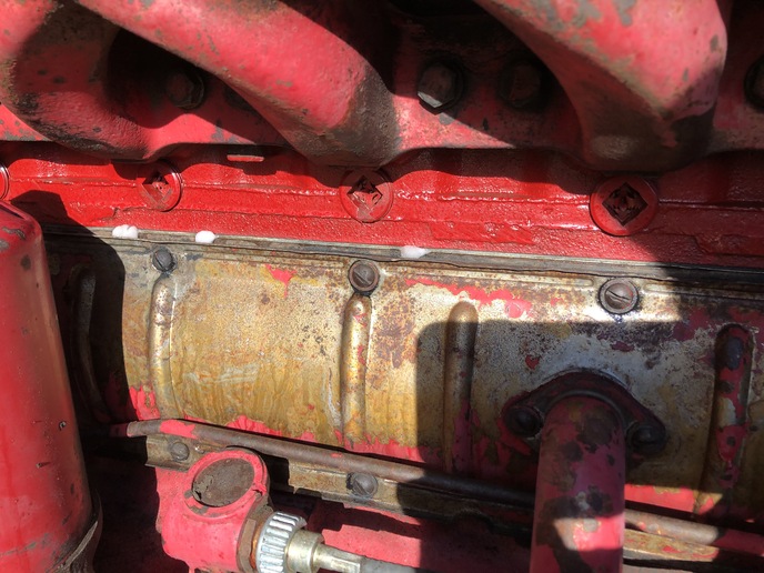

i have come to the conclusion these felpro gaskets are junk. i did the head on my 660 3 years ago and the compression is leaking right
through the gasket on the left side.i sprayed a soap mixture and she is a bubbling out side, and i have small bubbles in rad. enought to make it foamy. i even retorqued the head yesterday as a last
attempt before tear dowm. and the other thing is how can a head gasket be over 200.00 and not do its job! i will be looking for victor gasket
now. all this old stuff has just got priced out of reason.
