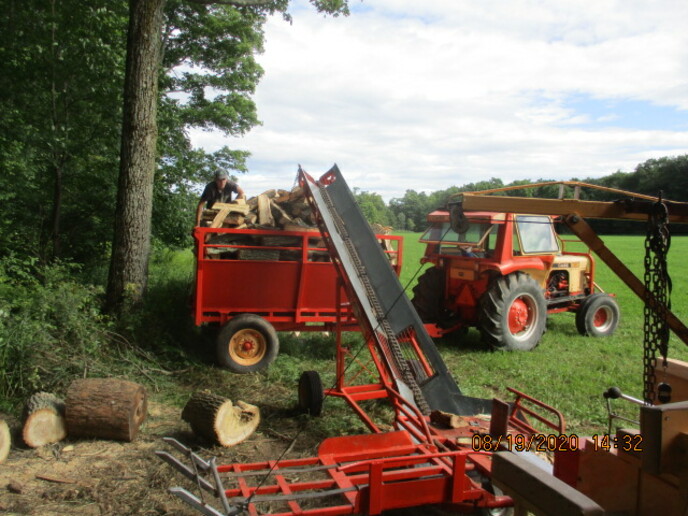

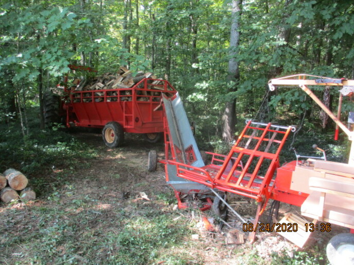

Dustin and I made a load last week in smaller trailer (about 1-1/4 cord), and today we filled the big trailer with a bit over 1-1/2 cord. It is supposed to rain again tomorrow and Wed. so we will unload and stack what we processed today in the woodshed tomorrow, weather permitting.----I do all my skidding in the woods with my Kubota B2150 equipped with loader and shop built 3pt skidding arch. It gets in between the trees well and leaves very little collateral damage. Things go pretty quickly when the logs are blocked and Dustin just has to set them on or roll the heavy blocks to lifting tray on my shop built splitter and elevator.
I have built swing out tool racks onto the sides of my processor tractor to carry everything we need when processing wood, including places to hold saws, and splitter fuel and food and drink for ourselves.
Todays load with the bigger trailer and my 831C.
The lifting tray can be mounted on either side of the splitter and folds up over the splitter for transport. I recently built a stabilizer leg assy. that I can adjust to support the splitter rather than just suspending it on the 3pt of the tractor and that also folds up by removing one pin and folding the legs up and putting the pin back into a transport position.You may have also noticed the comfy seat in the earlier pics. I don't always have Dustin's help, so when he is not here my wife comes up and runs the splitter and elevator for me while I gather up and split the blocks. Elevator is powered by the splitter only when the cylinder returns to retracted position. Just a single spool valve and elevator does not have to run constantly. The elevator gets hooked to a hitch on the back of splitter for transport.
