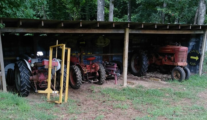

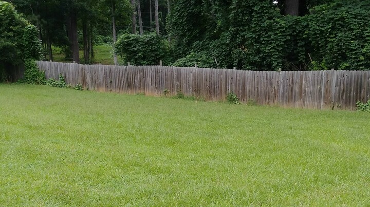

We are trying to plan ahead a bit. With lumber prices skyrocketing at some point things will slow way down for us work wise. We want to build an open shed to hold hay, to sell this winter. Looking at 12 x 48. 7 ft tall on back where fence is. About 9' in front. Will stack hay on pallets. Sould we kill the grass first? Lay some landscape fabric down? Put pallets up on 4 x4 treated blocks? Any ideas welcome.
Will be like tractor shed. Zero snow load issue in central Al. So not looking for span and load advice. Lol
