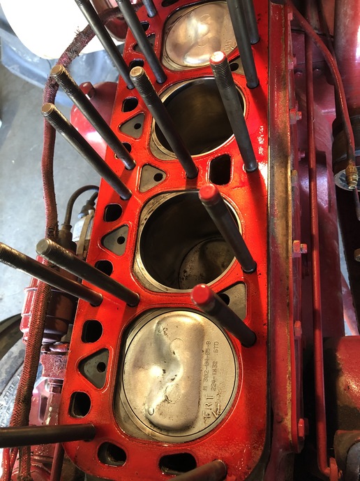

i use permatex high tack sealer. always have and probably always will as its proved its self for the over 40 years i have been using it.it never hardens and easily removable. you sure dont want shellac on gaskets. i had a head redone on this super W4 last week as the other one was cracked. reu
reused the same gasket too.
