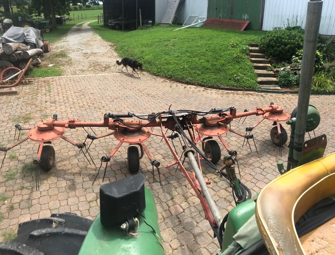

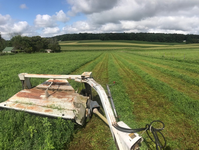

Time to get the 3rd cutting alfalfa grass hay done. It rained very hard Friday evening. Might have been 2�. And we had 3� from the Tropical storm last Monday. So on Saturday morning we put the repaired rotor back on the tedder and mowed one field. I decided to try the technique mentioned on this site of setting the windrow shields tight and tedding the windrows after a few hours of ground drying. To be honest, I don�t think I like it. Keep in mind the hay was soaking wet when cut. But the windrows were starting to warm up 3 hours later and not all of the hay spread evenly. There were a few bunches that didn�t spread out until tedded a 2nd time. These were still warm and had that funky smell. Worth trying but I think I will just spread wide as I normally do.
