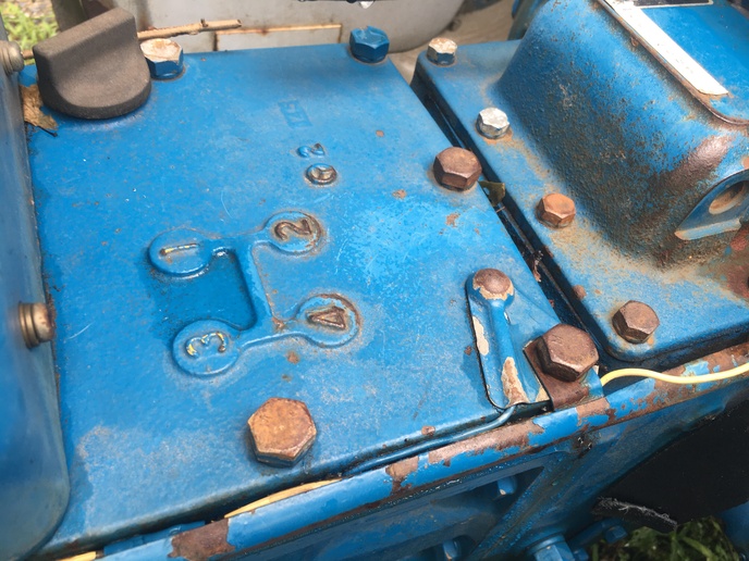

neutral saftey switch
Posted by Andy C on July 23, 2020 at 17:08:45 from (71.185.60.244):
A customers FORD 1910 will not start unless one jiggles the shifter. I think it is the neutral safety switch and the picture shows where I think it is. My question is, does removing the little cover allow access to the switch? Have to work on it next week so just trying to figure out a bit in advance.
Thanks,
Andy
