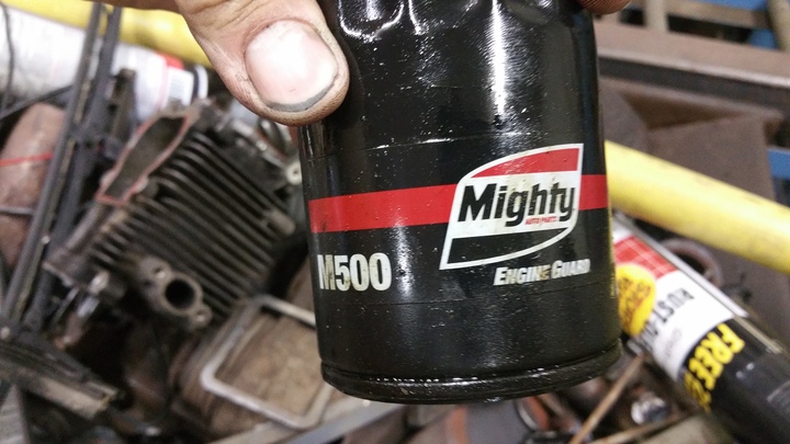

The offending filter on the 6.0. I
haven't cut it open to look yet. I did
the delco on my other truck, but didn't
really see anything that stood out to me.
