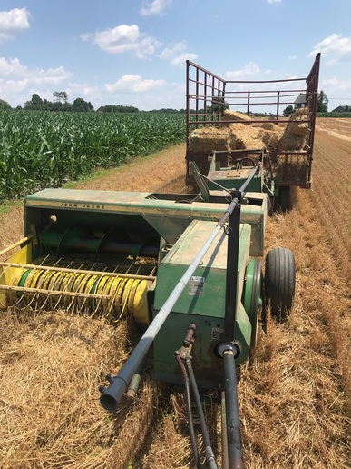

My baler breaks a flywheel shear bolt occasionally and I don�t know why. The needle plunger stop rod was getting the connecting link holes worn bigger, allowing the stop to hit the plunger pitman arm.so check all that.
On your kicker, I agree the inner spring may be cracked. I replaced both of mine.
