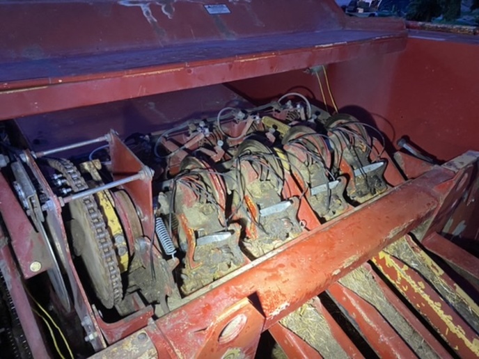

Got the needles almost in sure Is an easier job with two people I�ll tell you that know making one quarter turn then crawl up the ladder and find need to go an 1/8 of turn check the other way .
Left to right is pretty close now I need to set the distance between the needle and twine discs . Will the twine tend to pull the needle away from the knotter frame ?
