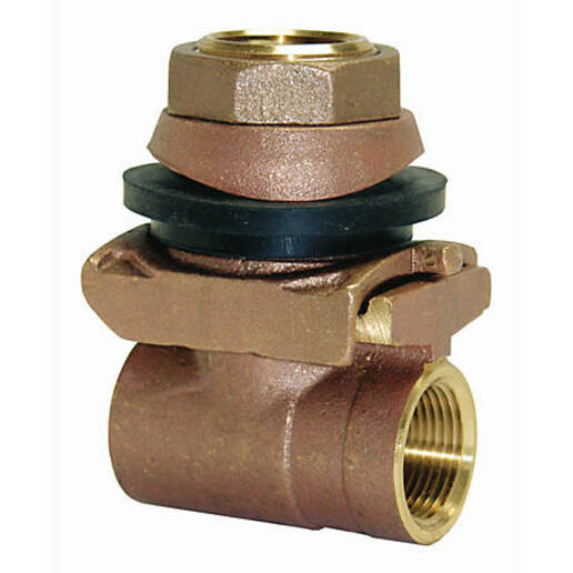

I assume you mean 3/4 hp, not inch! I have never seen a submersible smaller than 1 inch discharge. It's fairly easy to put in a pitless adapter, all you need is a decent drill motor and a 2 inch hole saw. I have installed a few of this type, it seems to be the most common and user friendly. I think it would work in an 8 inch casing, I have always had 6 inch. Don't know where you live, but Menards sells pretty good submersible pumps for <$300, I have used a couple of them. If the well has good recovery a shallow well pump might work fine too, maybe you could borrow or rent a pump to test pump it.
