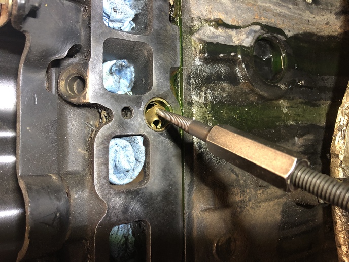

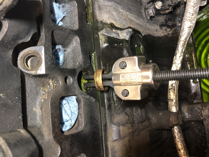

Welch plug update from yesterday
Posted by old560 on June 30, 2020 at 09:01:01 from (65.158.146.2):
I figured if I was going to drill some holes in it I might as well try a slide hammer. Then I used the puller for pilot bearings and it popped right out. It was just too little and too deep to try a prybar, or screw driver. Any plugs I find at Napa Have to small shoulders on them I don�t think it�ll seal good so I�ll call the dealer.
