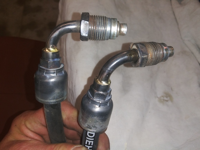

Thank you Check Break.
There are 6 of these type fittings that
go into a manifold in the bolster.
The two of them on top required a 90
degree bend to get them in there.
Those I bought the fittings and brazed
them to my old ones.
Easy enough but Expensive for the parts.
The other 4 are in a Very tight location
and I'd like to change the routing of the
hoses to make it easier for future access
- have to remove the bolster to get in
there. The nuts on a couple of them are
pretty hacked up too.
The right fittings would sure help.
It might be easier to make a new manifold
for under there and I'm considering that
as an option.
